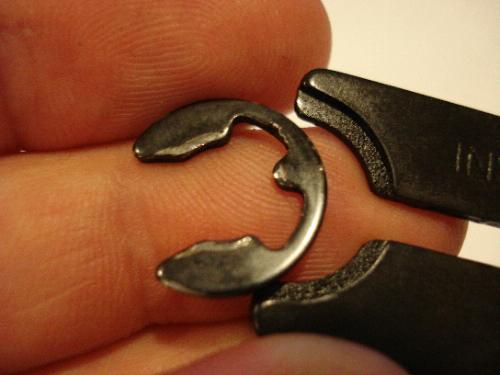

For the mechanically challenged... an e-clip tool

1st. - I would cut the bolts down my self, its a simple, simple, spin a nut down, cut it with a zip cut, touch it up on the grinder and spin the nut off to correct any thread burring.
2nd. - that tool will not work with the engine in place and I have had those clips on speedo cables and such half way on when it goes Twiiiiig and the f#@@8! is gone forever.
3rd. - to much trouble when a little dab of blue Loc-tight will hold the original bolt with out damaging the threads. All of the new aluminum V6 engines have more then a few of these little B@$$#rds at 10 inch #s only held in by blue Loc-tight.
